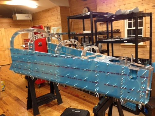

Brief Description:  Tailcone
Aligned the longerons with the top of the side skins and edge of the bulkhead plate. Match drilled the skins to the longeron. Match drilled all the side skins to the bulkheads and supports. Turned the tailcone over and match drilled the bottom skin to the side skins. Prepared the forward upper skin. Clecoed the most aft support in place.
