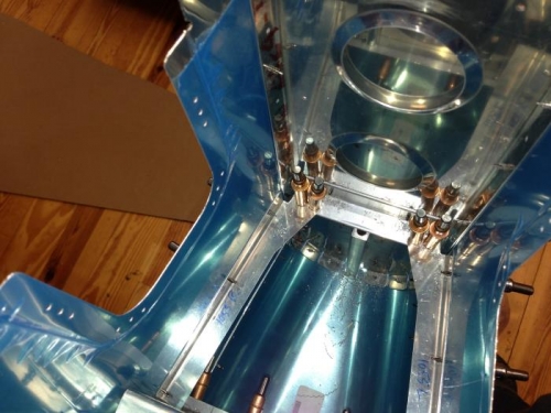

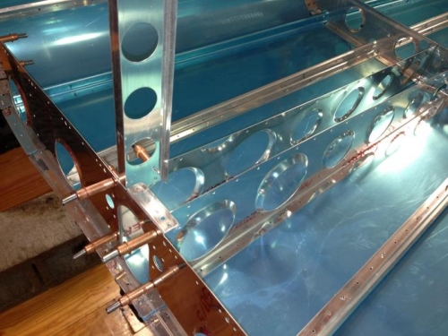

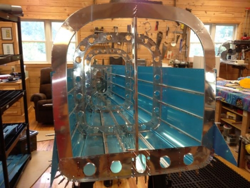

Clecoed the aft bulkheads to the tailcone. Left stiffeners installed as well as the left skin. Match drilled the stiffener holes. Rudder stop skin stiffeners and rudder stop brace installed after assuring tailcone was level. Attached forward bulkhead and bell crank ribs. Bulkhead channel installed.
Rudder  Stop and rudder stop brace
Bell crand ribs and bulkhead channel
Tailcone with forward bulkhead attached
