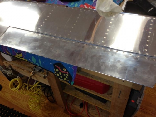

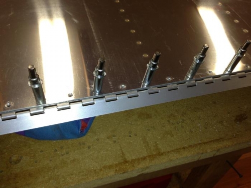

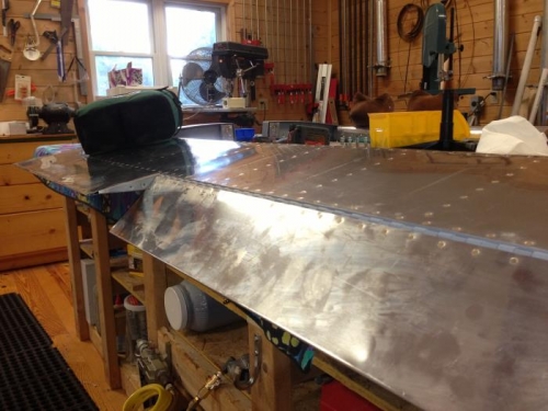

Finished cleaning up the trim tabs from tank sealant. Cut the trim tab hinges and fitted them to the trim tab and elevator. Rivetted the hinges to the trim tabs and elevators. Placed the hinge pin in place. Bent the hinge pin on the inboard side and drilled a 1/16 in hole for the safety tie to hold the hinge pin in place.
Hinge clecoed onto elevator
Trim tab onto elevator
Trim tab on elevator
