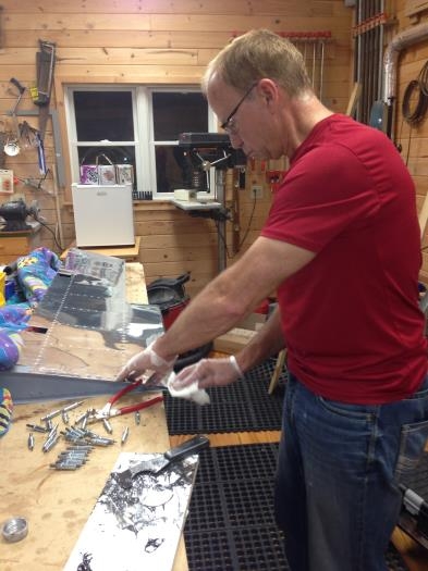

Prepared the foam ribs for the trailing edge. Mixed up tank sealant and applied to foam ribs and trailing edge. Originally planned to attach an aluminum angle iron to the trailing edge to make sure it stayed straight during tank sealant set up but decided to remove the aluminum angle iron. I was afraid it would be difficult to remove from the elevator skin.
Clecoing trailing edge after tank sealant
