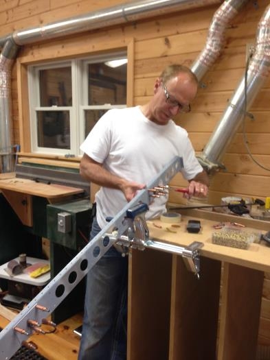

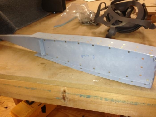

Finished priming with 7220 and then spraying with lacquer finish as a filler. Riveted the counterbalance skins onto the tip ribs. Added the hinge plate reinforcements and the associated nut plates to the front spar. Placed the machine end of the AN470 rivets on the outside of the spar .
Adding hinge reinforcement plates to front spar
Tip ribs with counterbalance skin
