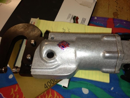

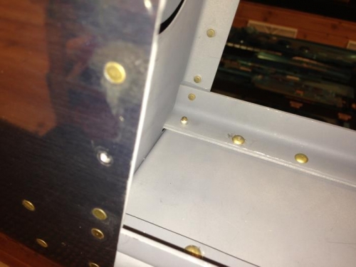

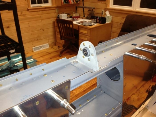

Received the Cherry Max rivets from Van's today so I could finish the horizontal stabelizer. I had neglected to rivet the spar web to the inboard ribs and stringers and the most outboard rivets could not be driven. Options were a structural screw or Cherry Max rivets. I used the latter with good success. I installed the rear spar and riveted it into place with pull rivets to the inspar ribs and driven flush rivets to secure the skin to the spar. I used my new pneumatic rivet squeezer. Very sweet. Big time saver. Finished deburring one to the disassembled elevators. Next is to match drill the other elevator and debur those holes.
Rear spar
Rear spar
Pneumatic squeezer
Pneumatic squeezer
Cherry Max rivet in corner of spar web
