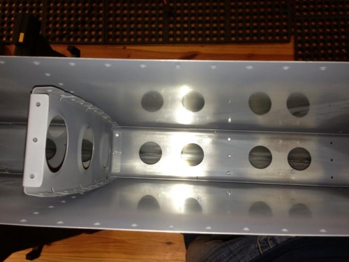

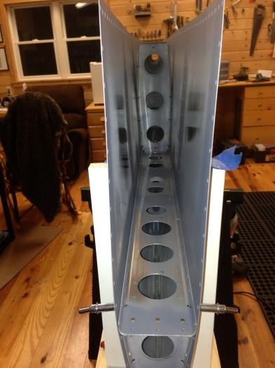

Finished riveting the nose ribs into the skins. Placed the front spar and attached ribs into the skins and began to clecoe into place. Riveted the nose ribs to the front spar using pull rivets on the second and third ribs on each half. The inboard and outboard nose ribs can be attached with universal head rivets.
Center section of stabelizer
End view of horizontal stabelizer
Inside view of stabelizer with rib in place
