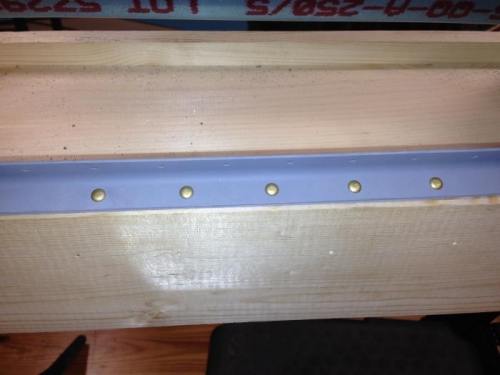

Brief Description:  Horizontal Stabelizer
Began riveting the stabelizer together. Riveted the inspar middle ribs to the stringer web. Then riveted the stringers together. Cleocoed that assembly together and then to the forward spar. Then clecoed the remainder of the ribs except the aft 2 ribs to the spar and began riveting those ribs to the spar.
Stringers riveted together.
