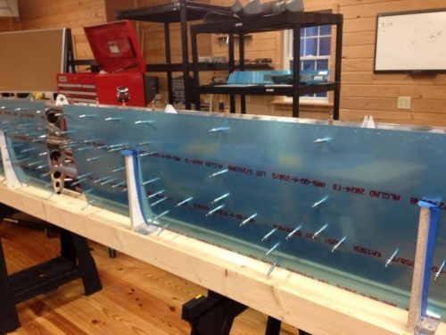

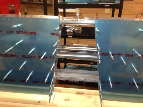

Set the skins inside the jig and clecoed the nose ribs in place. Then added the front spar and in spar ribs. The spar caps were added and all ribs, spar caps, and spars were clecoed in place. Added the rear spar to the assembly. Next step is to match drill all the holes. Probably 250 or so holes which then need to be deburred, after I dismantle the entire assembly.
Horizontal Stabelizer in Jig
Spar caps in stabelizer
Rear spar, spar caps in center section
