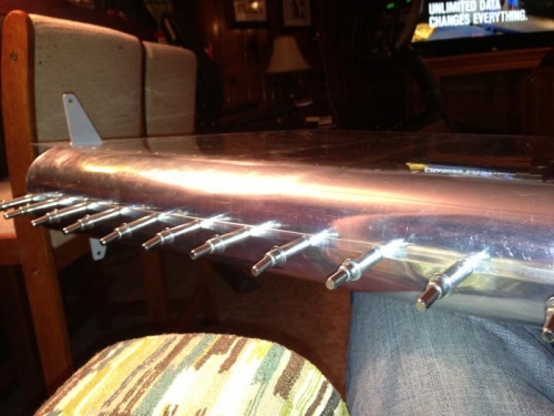

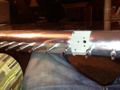

Rolled the edges of the forward edge using a broom stick for the upper portion and a 1 1/2 inch piece of PVC pipe for the mid and lower sections. Two short areas when some creasing of the skin at the spar occurred, but overall very pleased with the outcome. Once again, followed Van's directions and it worked.
Forward Edge
Forward Edge
Forward Edge
