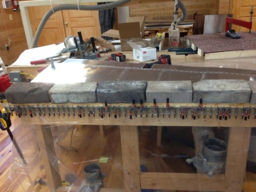

Brief Description:  Closing up Rudder
Began preparing the parts for the front spar on the horizontal stabelizer. Cut down the front spar caps. Prepared the rudder for closure. First experience with tank sealant. At first I placed the left stiffener on top of the shear clips and had to drill those pull rivets out. Finally got al the rivets in place and clecoed the aft skins together. Placed weights on the skin and need to set aside for a couple of days.
Closing up rudder
Closing up rudder
