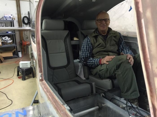

Installed the back seat back rests, seat cushions and front seats into place. Installed all of the inspection panels and center console. Then Brent Bowman and I performed a weight and balance with his airplane scales. Empty weight is 1639. Calculated the weight and balance to include most fwd CG, most aft CG and first flight CG. First flights will include my observer pilot.
Seat installation
Seat installation
