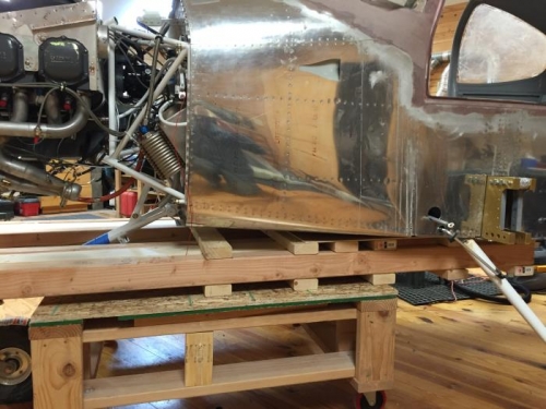

Brief Description:  Plane removal from workshop
I need to remove this project from my upper floor workshop down to the lower floor. To do this I am building a palette out of 4 4x4s held together with crossing 2 x 4s. The palette rests aft under the main spar and fwd I will build supports from the palette up to the lower engine mount. I plan to strap the main spar to the aft palette and the engine mount to the more fwd palette. I will have my farmer friend Bob Groulx use his fork lift to lift the palette and plane out of the workshop and down to the lower level.
Beginning palette
Beginning palette

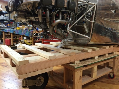

More structure to palette
