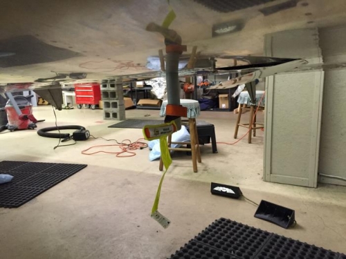

Date:  4-28-2016
Number of Hours:  12.00
Brief Description:  Wings
I opened each inspection plate under both wings and torque those nuts that had not been torqued and placed red fingernail polish on the nut. I installed the pitot mast and pitot tube in place. I routed the wires so they would not interfere with the aileron linkage. I then turned on the power and obtained heat to the pitot tube.
Pitot tube
Pitot tube
