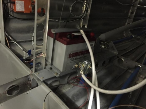

Brief Description:  Battery installation
I purchased a Concorde battery from ACS and installed it immediately aft of the baggage compartment. I purchased a diode to protect the battery contactor but have not installed that yet. Positive and negative wires have been run forward to the firewall.
