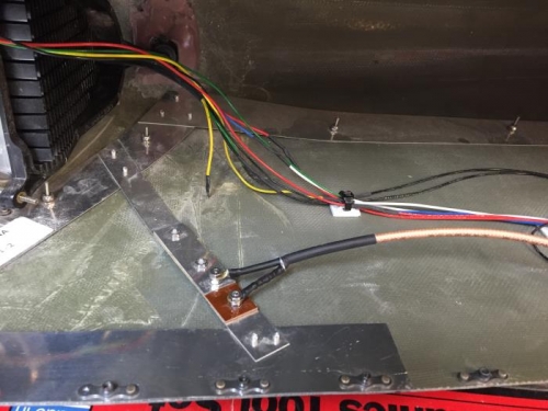

The R wingtip has the VOR antenna. I needed to attach the coaxial cable to the antenna. I stipped the wire and placed the ground to the main arms of the antenna, as called out in the instructions, and the center conductor to the small portion of the antenna. I then secured these to the wing tip with zip ties and sticky mounts.
Coaxial attached to VOR antenna
