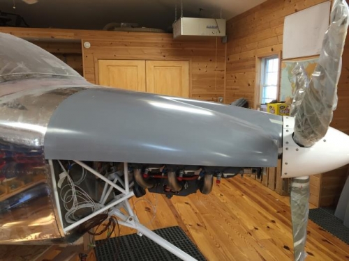

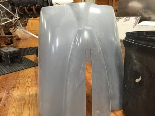

Further wires runs. Needed to solder some wires from wing tip landing lights together before entering into the central P1 CPC connector. Running all wires now to the P1 CPC connector. Have installed the BNC and TNC connectors for the Comm antennas and GPS antennas and then installed these behind the GTN 750. Installed the music jack into the panel. Started to install the cowls. Since I have installed the MT 3 blade prop, I need to extend the slot on the under surface of the lower cowl to be able to remove it.
Slot extended forward 24 inches.
Fitting upper cowl
Fitting upper cowl
