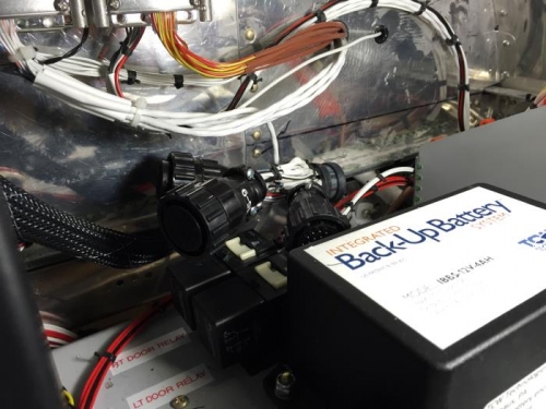

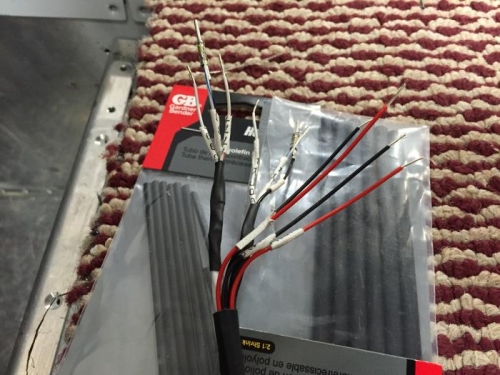

Deciding where behind the panel to route harnesses. Making sure all edges of the aluminum are protected with catepillar strips. Most of the harnesses will be behind and above the lowest part of the panel so they will not interfere with the rudder pedals. In addition, I am shortening harnesses so they fit without having to coil up the redundant harnesses. Began pinning some of those shortened harnesses.
Pinning wires
Pinning wires
CPC connectors behind panel
