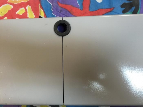

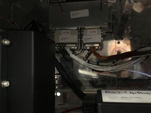

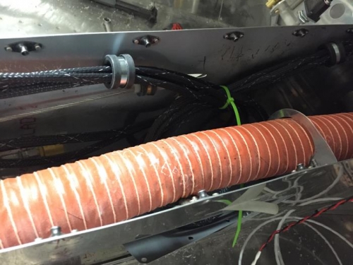

I have begun routing wires from the instrument panel or from to fuselage to the instrument panel. I am attempting to keep most along the fuselage sides until I get under the panel. I will then connect them to the panel connectors as supplied from Aerotronics. I elected to route the headphone jacks through the tunnel as well as the hand grip harnesses that will hook to the Tosten handgrip harness. I used Adele clamps to attach the harnesses to the sides of the tunnel and away from the elevator cables. I will pass the wires into the tunnel below the panel and through a grommet I placed in the cover to the tunnel. I split the cover at this point so that I can remove the wires if necessary. The grommet is split to so that it will slip around the headphone jacks.
GEA 24
GEA 24
Headphone jacks in tunnel
Tunnel cover
Tunnel cover
