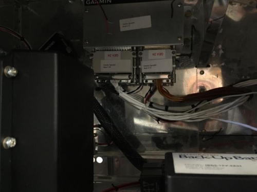

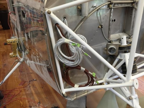

Reinstalled the panel and began routing wires to attach to the panel. There is an engine interface module, GEA 24, that I attached to the subpanel behind screen 2. I also attached the ground bundle slightly inbd of this on the subpanel. I plan to run a #8 guage wire from it to the ground bus on the firewall. I ran the EGT, CHT, Fuel pressure, oil pressure, MAP, alternator shunt, tach, and oil temp lines from this engine interfact through the subpanel and firewall. All those will attach to the engine. I began to route wires to the panel for connections. I added extensions onto the flap position indicator, soldering them and ran them into the fusealage and forward to the panel. Brent Bowman and Dave Burgiss were over today to assess my progress and comment on my technique. Neither saw any problems and complemented me on my riveting and construction techniques.
Engine interface module
Wires run to engine compartment from engine interface module
