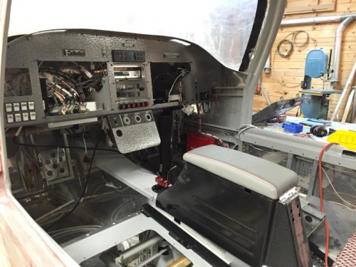

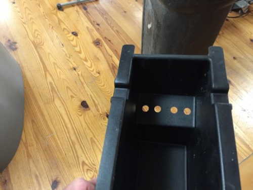

Trimmed some more the outbd edges of the panel and placed it back in the aircraft. I unfolded all the wires to see where they lay. I believe I will run the headphone harnesses and jacks through the tunnel. This will keep them away from strobe wires I have run along the outbd fuselage sides, mostly on the left. I will insert the pilot/copilot jacks inside the center armrest console from Aerosport. I will insert the rear seat passenger jacks in the rear of the console. I removed the very front of the center console as it came from Aerosport so that I did not have to modify my Andair fuel valve stem. I may modify the instrument panel for throttle controls to accomodate my iPad but have not decided for sure.
Second panel fitting
Pilot/copilot jacks
Pilot/copilot jacks

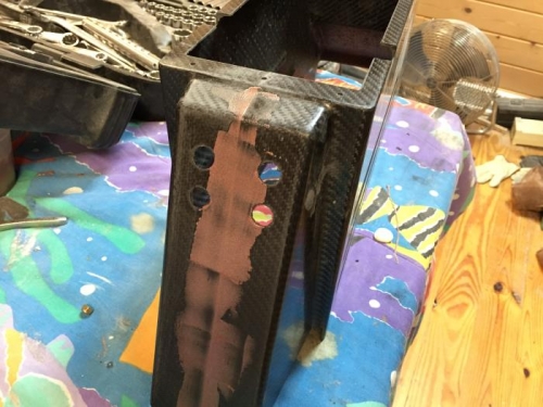

Rear seat headphone jacks
