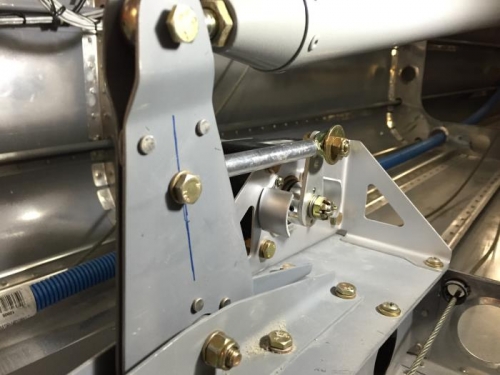

Brief Description:  Pitch servo
Installed the GSA28 pitch servo. It is placed immediately aft of the battery in the empennage. It requires a bracket to attach it to the battery support. I followed Garmin's directions to place the unit into position. No issues other than that servo is now 15 inches from the location I planned to place the magnetometer. I will need to find a different position for the magnetometer.
GSA28 pitch servo
GSA28 pitch servo
