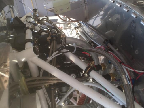

Brief Description:  Wire routing
Jim Dobbins visited my project and noted several wires that I have zip tied to the engine mount. He suggested I Adele clamp them. I removed the zip ties and used Adele clamps to prevent chafing of the engine mount. Also on the prop governor, the push rod control had an AN -960 10 washer and I replaced it with an AN 970-3 washer to prevent the bolt from slipping out of the control arm.
Wire routing
Wire routing
