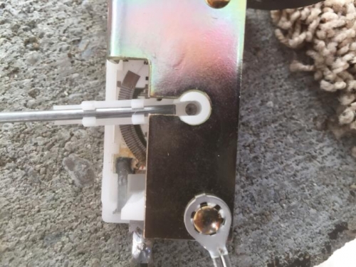

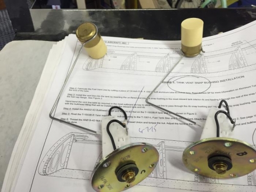

Brent Bowman helped me remove the fuel sender from the inbd tank rib. I prosealed this in place per VAn's instructions so it was difficult to remove. When I removed the unit we noticed I did not make the last 90 degree bend in the end of the float rod that would have secured the float to the sender. The float simply floated around in the tank and did not affect the sender readings. In addition, the left tank float had become completely detached from the sender. I then cleaned the proseal off the inbd tank rib and cleaned out any debris inside the tank from the proseal. Awaiting arrival of the new sending units which I plan to install with propylene gasket and not proseal.
