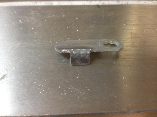

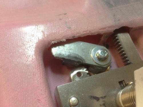

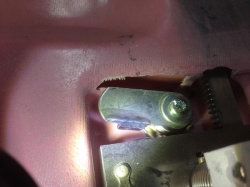

I had a small tab Tig welded onto the lock tang. With this in place, the upper pushrod assembly cannot slide over or under the lock and therefore will not bind.
Tab welded on tang of lock
Upper pushrod assbly stopped by lock
Tab on tang of lock
