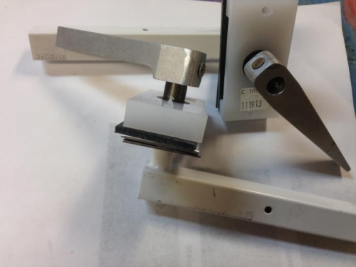

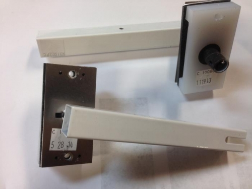

Finished installing the hinges on the door and then removed the hinges to begin assembling the door handle/locking mechanism. Attaching the handle to the handle assembly requires tapping holes in the handle to accomodate a countersunk hole that holds the handle to the handle assembly. Needed to make another trip to Sears to purchase an 8-32 tap. Once the handle plates are aligned a #10 drill is called for to drill top and bottom holes. Only had a #12 so once again improvised. Will need to widen these holes a bit to accomodate the #10 screw. Brent Bowman, A & P mechanic visited my project today and offered some suggestions regarding brake lines and engine installation. He thought the fuel lines, riveting and electrical looked good so far.
Door handle and handle assbly
Door handle and handle plates
