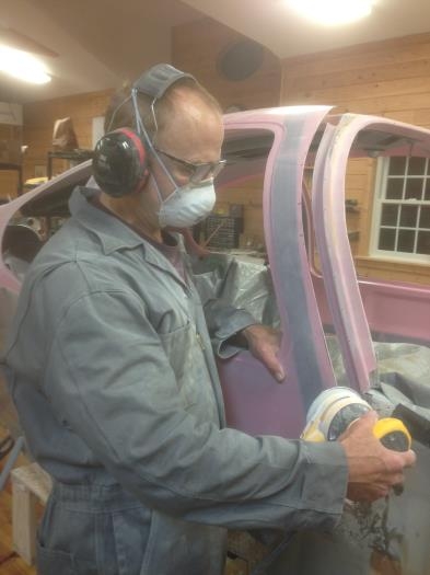

Brief Description:  Fitting doors
Oh th arduous task of trimming the doors. Once the inner and outer skins are glassed together, they are clecoed to the frame. Then the edges are trimmed so the door can fit into the frame. Sand, then fit, then sand some more, then fit test again. Over sanding causes a nasty gap that would require patching with fiber glas so just need to sneak up on the fit.
Trimming the doors
Trimming the doors
