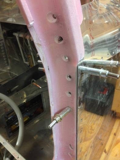

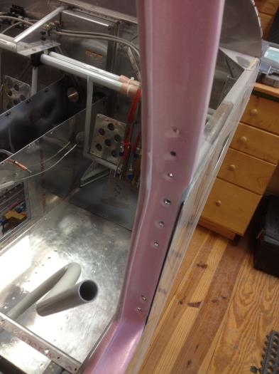

After trimming the excess fiberglas off the doors, I placed the left inner and outer shells and right inner and outer shells on the cabin top. In order to fit them correctly it was necessary to trim back the cabin door inner lip to allow the doors to set within the door opening. Burned up two dremel tools and multiple bits. Purchased a rotozip tip and was able to trim back the fiberglas. Then sanded the surfaces smooth and replaced the cabin top on the fuselage. I was then able to mate the doors to the fuselage.
Doors fitting on fuselage
Cabin door inner lip before trim
Cabin door inner lip trimmed
