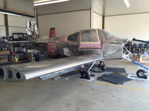

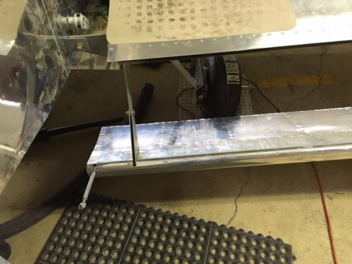

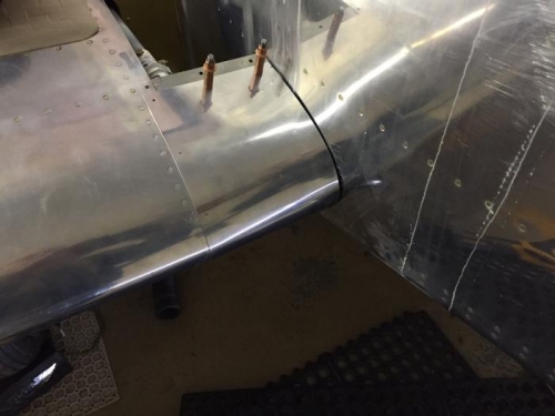

I placed the wings on the rolling cart I used to move the plane around in my workshop. I needed to add some padding including rolled up rugs to get the wings high enough. They easily mated with the spar and using 4 guide pins I created from 3/8 bolts I temporarily attached the wings. I then attached the flaps and filed them on their inbd sides so they would not contact the fuselage. I then formed the lower fairing around the leading edge of the wing. I needed to grind away some of the inbd metal of the fairing so it would not touch the fuselage.
Wing attached
Wing attached
Lower wing fairing shaping
attached flap
attached flap
