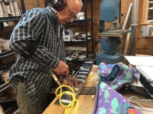

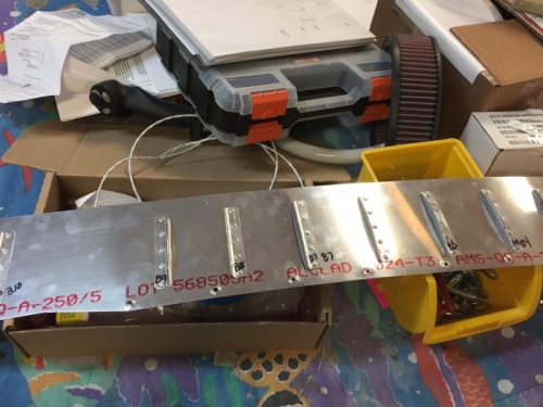

The upper wing root fairing can be constructed before attaching the wings so I did that. The stiffeners are placed only in the upper fairing as it may get some abuse. Back riveting works nicely to set these rivets flush with the surface. Shawn Cogan helped me drill, clean and deburr the holes.
Placing rivets in stiffeners
