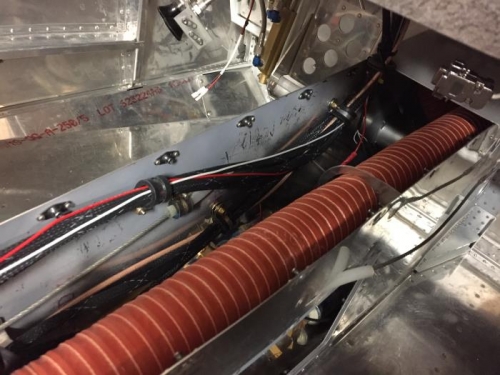

Date:  2-24-2016
Number of Hours:  5.00
Brief Description:  Headset harnesses
The headset harnesses, ADSB coaxial and the flap motor wires run from the panel back through the tunnel. They need to be secured away from the elevator cables. I used Adele clamps to secure the harnesses, coax and wires onto the left side of the tunnel. Wire ties were used to secure loose parts so they would not rub against the elevator cables.
Headset harnesses along left side of tunnel
