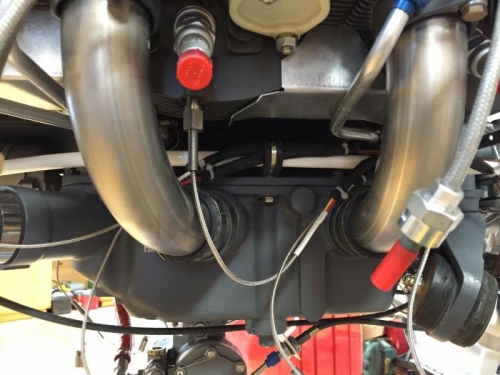

The EGT and CHT wires along with the starter power on the left and the alternator wires on the right needed to be secured to the engine. I used Adele clamps in three positions on each side to secure the harnesses and cables to the engine. The cables do not touch the engine. The spark plug wires were secured to the engine also with Adele clamps on the outside of the cylinders.
Wiring tied to engine
