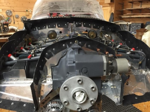

Brief Description:  Baffles
Finished placing the aluminum baffles around the engine sizing them appropriately. I then placed the air seal around the entire top of the baffles. The air seal protrudes about 2 1/2 inches above the aluminum baffles and still lies flat when the cowl is in place. I found that by placing a small V notch in the bottom of the air seal, when attached to the aluminum baffle it will roll in thus making it conform better to the cowl.
