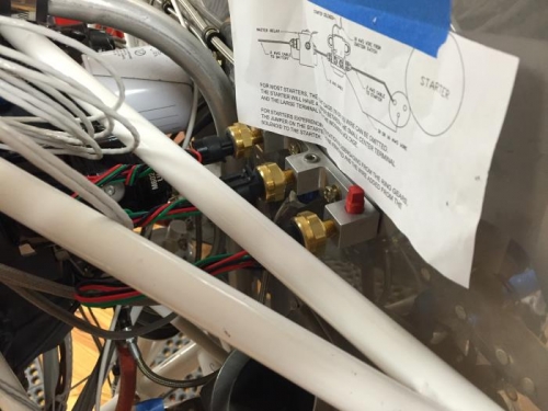

I began to install parts onto the engine. I placed the alternator onto the engine but have not secured it to the engine. I placed the fuel, oil and manifold pressure transducers onto the holder where I can run lines and wires to the transducers. I placed the exhaust system in place so I can see where to run wires. I drilled #30 holes 3 inches from the manifold into the exhaust pipes to accomodate the EGT probes. I will run those wires inbd of the pipes so they are not visible from the outside.

Fuel, oil and manifold pressure transducers
