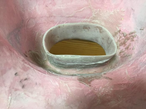

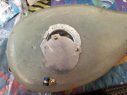

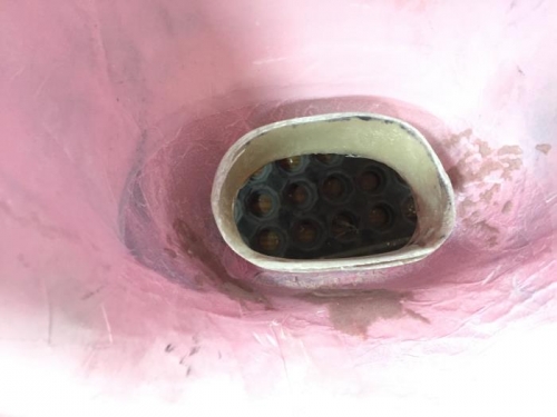

There needs to be an alternate source of air to the carb in the event the cowl inlet freezes or a bird gets stuck inside. I followed the plans and the installation was easy. I wish I would have installed the door further fwd. It would make it easier to attach the cable to open the door. When I first fashioned the cowl extension to the FAB the extension was higher than the FAB portion. Therefore I needed to add further layers of cloth to the upper extension of the cowl. I needed to grind away a portion of the lower cowl extension and place new cloth. After this was completed the cowl extension fit nicely to the FAB. After chipping away the foam form, I placed one layer of BID in the fillet to secure the extension to the cowl.
Alternate air door
Alternate air door
Cowl to FAB
Cowl to FAB
Finished cowl to FAB
