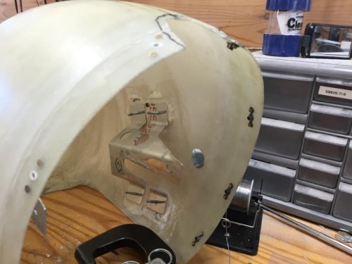

Date:  1-1-2016
Number of Hours:  3.00
Brief Description:  Nose wheel
I had not finished the nosewheel fairing. I needed to install nutplates so the fwd portion could be attached. Also I trimmed about 1 inch around all surfaces that are near the wheel to prevent snow/slush from accumulating in the fairing. I plan to fly off my 40 hours without wheel pants.
