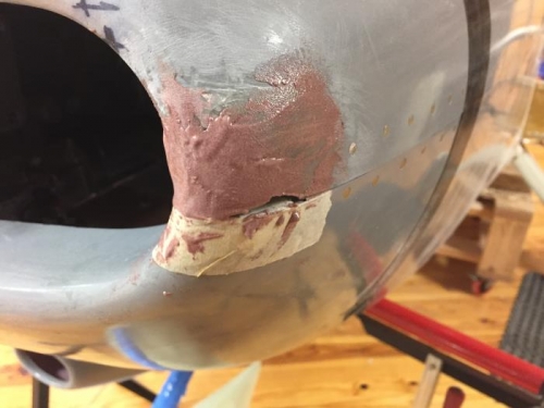

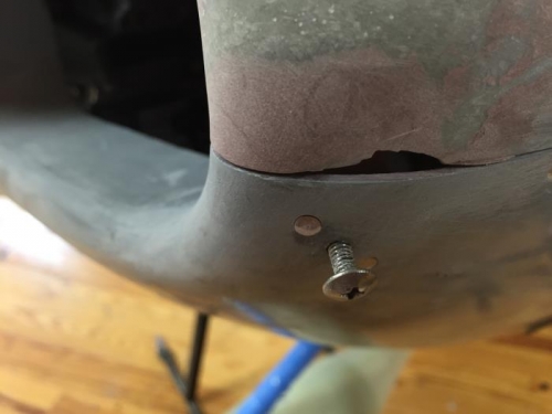

Brief Description:  Cowl
The most fwd and outbd edges of the upper and lower cowl did not match. Therefore I built up the shy surface with cloth and then faired in with resin/epoxy. The cowl segments match perfectly now. The slot in the side is for the pin that slides into the hinge holding the upper and lower cowl in place.
building up cowl
building up cowl
finished cowl
finished cowl
