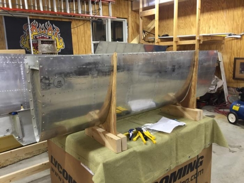

Pressure tested both tanks this evening and found no air bubbles. I placed a small balloon over the vent, then pumped a low pressure air into the fuel sump location. I sprayed soapy water over all the rivets and junctions and saw no air bubbles.
