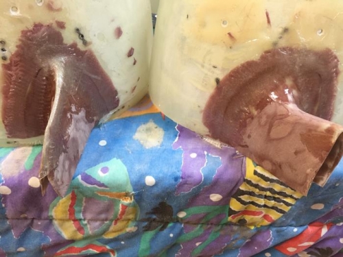

Brief Description:  Wheel pants fairing
I Cut down the fairings for the wheel pants and quick glued them in place. I then applied two strips of BID cloth to hold them in place. I will not fair them out with West flox. I Attached the CPC connectors to the wing tips and string tied the redundant wing tip light and wing tip nav light harness.
Wheel pant fairings
Wheel pant fairings
