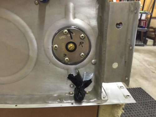

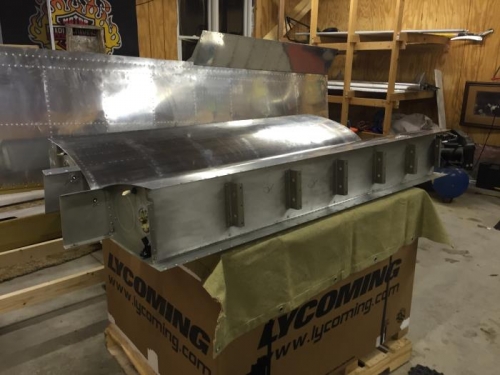

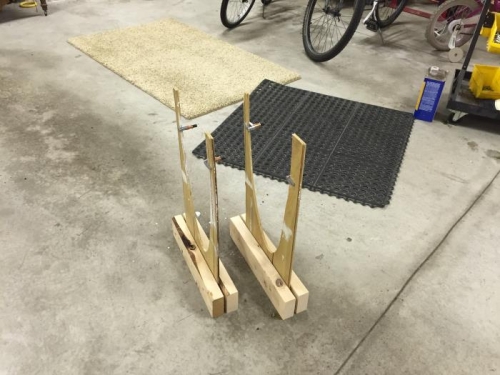

Shawn Cogan came over tonight and we removed the fuel tanks from the wings. There are 21 bolts to remove as well as several screws holding the skins to underlying spar. I built cradles to hold the wings steady while I pressure test the tanks. I installed the fuel level sender with tank sealant. I will need to let this cure for about 1 week before I add pressure to the tanks.
