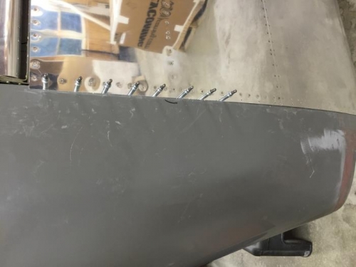

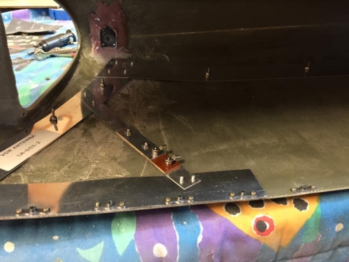

Finished the installation of the Bob Archer VOR antenna into the right wing tip. I secured the antenna with screws which are countersunk and will be covered over with fiberglas. I installed the antenna as far fwd as I could. I fit the left wing tip to the wing and drilled the holes for placement of nutplates. Also dimpled the skins to accept the #6 screws.
Fitting wing tip to wing
