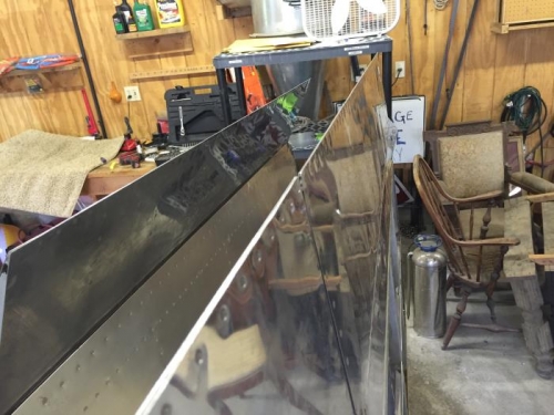

Placed the aileron and flaps onto their attachment hinges per the instructions. The QB wings have a few features different than the slow build. The hinges for the ailerons are built somewhat differently, but still install with no problems. Once the flaps are in the neutral position, the ailerons are aligned with them and that is the neutral aileron position. Then the wing tips can be fitted and installed.
