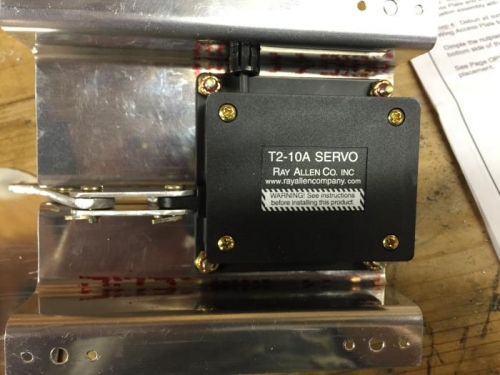

Brief Description:  Aileron Trim
I purchased the optional Aileron Trim Package from VAn's which uses the Ray Alllen Servo.I constructed the trim assembly as per instructions and mounted the Servo to the assembly. I then followed instructions to mount the assembly to the access panel, most inbd on the left wing. There is no interference between the assembly actuating arm and the aileron push tube.
Ray Allen Trim Servo
