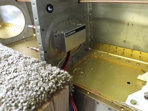

Brief Description:  Control box for Pitot/AOA

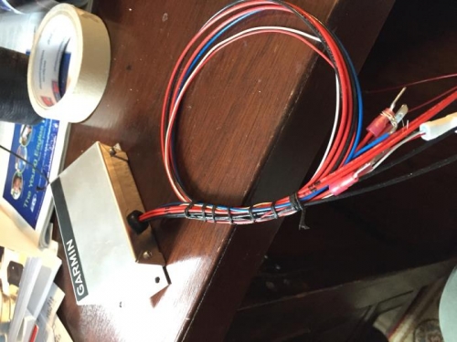

I riveted an aluminum piece to one of the lighening holes. Then placed nutplates on the aluminum piece so I could attach the control box in the event I need to service it. I string tied the wires for the control box to keep them away from the aileron mechanism.
Control box mounted to rib
string tieing the control box lines
