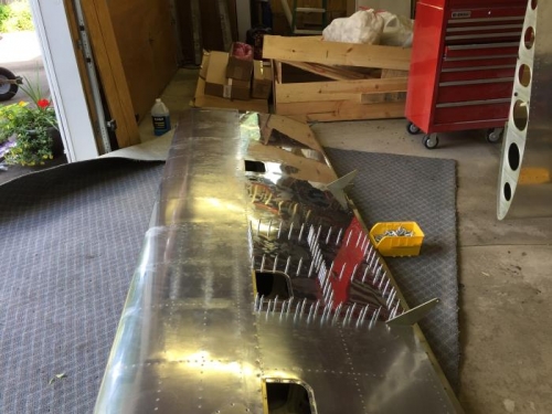

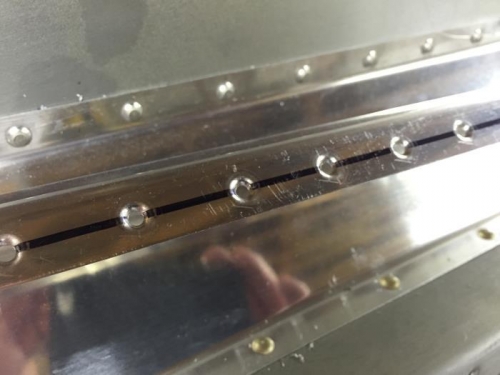

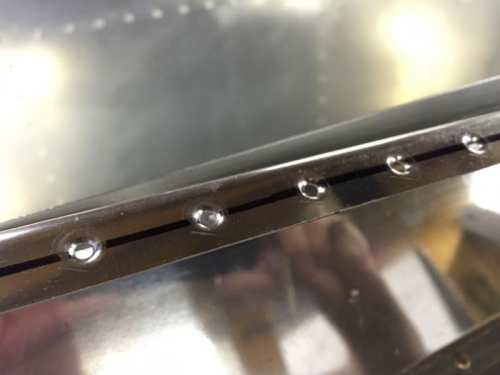

I cut the J cannel stifffeners for the outbd lower wing to length and placed them into the cut outs in the ribs. The wings were lowered to the floor face down. I placed the lower outbd skin in place, clecoed it and match drilled wll the holes for left and right wings.
