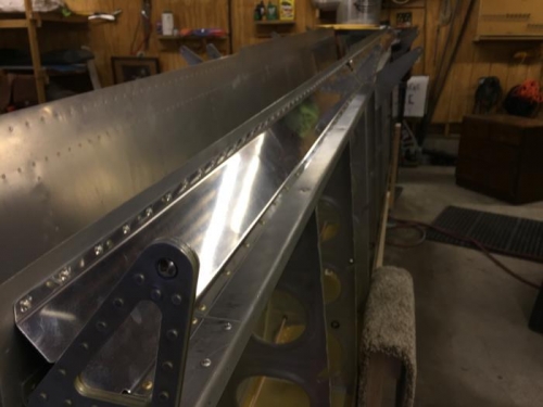

Brief Description:  Rivet flap and aileron gap fairings
Prepared teh aileron and flap gap fairings by deburring all holes. I dimpled the wing skinand accompanying gap fairings. I used the pneumatic rivet squeezer to set the wing rivets. I will need to use some pull rivets on the inboard flap gap fairings to rear spar because the wings were received with the inbd lower skin in place.
Flap and aileron gap fairings
