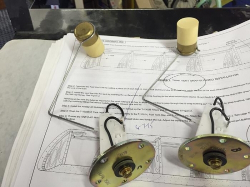

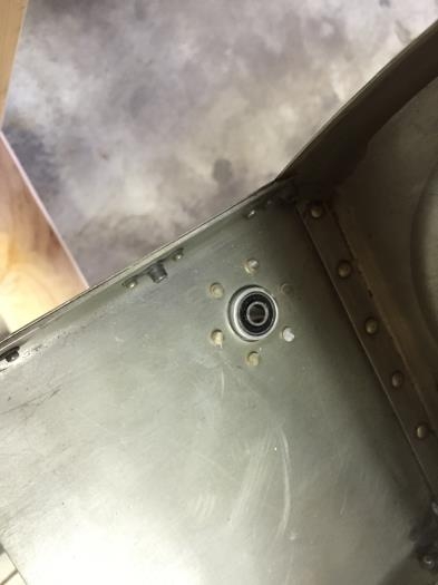

Reading through the plans and assuring that all aspects of the build were complied with. I believe I do not need to worry about the stall warning system as I am installing the Garmin pitot tube with AOA system. There was a bearing in the aft inboard tank rib sus-assembly that was not put in. I placed this and placed six AN 470 4 rivets in both. The I purchased the f-385 Fuel Level Sender from Van's, followed the directions for its build and installed these in both the left and right fuel tanks. It calls for tank sealant, however each comes with a rubber gasket. I have a call into Van's to see if I need to add sealant to the rubber gasket. Began considering installation of the Garmin pitot tube. There is a box with the pitot tube that sends information to the panel. I am trying to decide where to mount this. The aileron bell crank mechanism goes near this and I began constructing that before I place the box for the pitot tube.
Fuel level sendor
Fuel level sendor
Bearing
Bearing
