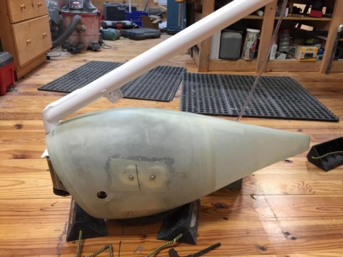

Date:  5-6-2015
Number of Hours:  6.00
Brief Description:  Nosewheel
I worked on fabricating the wheel pants for the nose wheel. Much like the main landing gearing fairings. What I noticed in my alignment was the aft portion height from the ground varies depending on the front end weight. I have epoxied the attach points to the fairing but I plan to finish that when I have the engine in place and can determine the final distance from the floor to aft portion of fairing.
Nose wheel fairing
Nose wheel fairing
