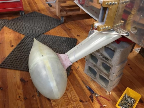

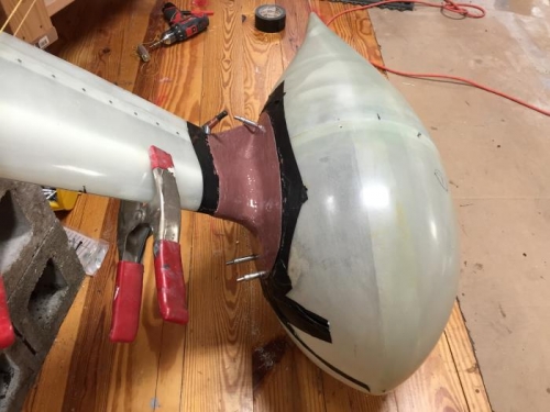

Construction of the wheel pants and landing gear fairing requires they follow a displaced centerline and point into the wind. Following the instructions assures this. Then the wheel pants need to attach to the wheel mounting brackets inside the wheel pants. I built up resin inside the wheel pants so they would 'embrace' the wheel mounting brackets. I then placed nutplates on the wheel mounting brackets. Attaching the front and rear wheel pants is accomplished with nutplates once the alignment is correct.
Left wheel pants
Left wheel pants
Right wheel pants
Right wheel pants
