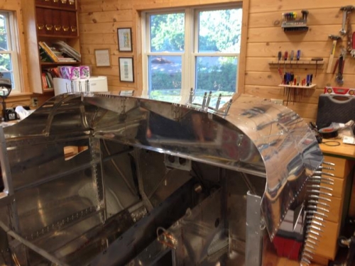

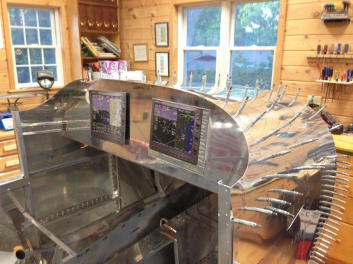

I attached the fwd fuselage skin to the assembly substructure with clecoes and match drilled all the attach holes. Disassembled the structure and cleaned and deburred all holes of skin and substructure. Dimpled all holes of the skin. Riveted the ribs and sub panel parts together with the help of Shawn Cogan. Shawn and I riveted the skin to the sub structure. Needed Shawn to help me finish riveting the fwd fuselage ribs to the fwd side skin. Also I noticed I had forgotten to rivet the center section side plates to the bulkhead side channels. This was difficult at this stage as I needed to place the rivet gun in a tight space in front of the landing gear mounts. It worked out fine.
Assembly test fit with clecoes
